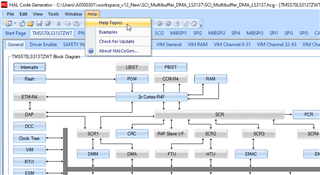

    You can find FEE example in HALCoGen itself.
    Go to the "Help Topics" section in HALCoGen:

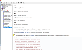

    Now in Examples section you can find FEE example:
    Here they explained in detailed with step-by-step procedure along with the example code.
    Just follow those steps.
