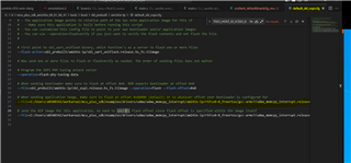

    First, keep the board in UART boot mode and next send all images in the cfg file through UART.
    Here, in the cfg file you need to update your app images . The cfg files have default app images .So,here you need to replace with your app images.
    Please look at the cfg file below, the highlighted one should be an application app image.
    You can comment on 30 lines which is not required.
    cfg path : C:\ti\mcu_plus_sdk_am243x_09_01_00_41\tools\boot\sbl_prebuilt\am243x-lp
