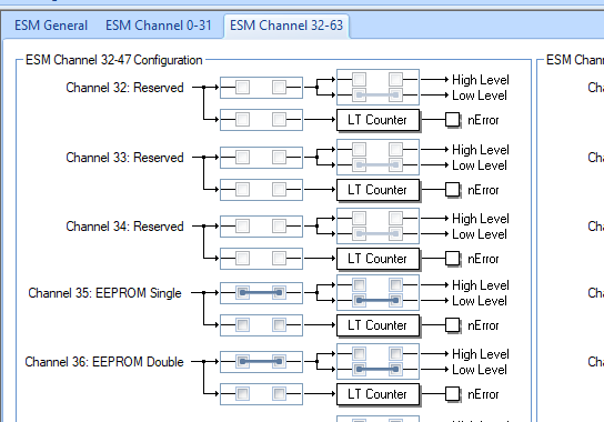

I configured the ESM like this:
Now I tried to enable the ECC Error detection

  • Hi Jens,
    I understood the root cause for the issue.
    If you refer the highlighted statement below:
    To trigger the ESM error for single bit flash errors, we should need to set the profiling. If we didn't set the profiling, then there won't be any ESM error for single bit flash error.
    So, i did the following modification in my code:
    For single bit errors case i just enable the Error profiling and also i set the single bit error threshold as 1(that means even one single bit error should need to trigger the ESM module).
    After doing this modification here is the result for diagnostic run for single bit error.
    As you can see ESM 1.35 flag got set, this is nothing but correctable error in flash bank-7.
    I am attaching my modified code for your reference:
    5756.FEE_ECC_Errors_TEST_RM46_New.zip
    Thanks & regards,
    Jagadish.
