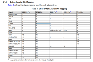

The CTI20 we already have does from pin 5 to 1 as the following table:
The new CTI20 received does from 5 to 1-3-5-7-11-13-15-17-19 and it doesn’t work
