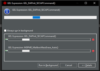

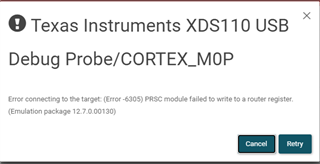

Hi Team,
I am working with LP_MSPM0G3507. And finding the issue after factory reset command. Cannot connect to LP_MSPM0G3507, but uni-flash tool can detect.
No matter CCS or Uni-flash, neither they can detect the LP_MSPM0G3507. I also tried 8737.Unlock MSPM0.pptx. It cannot work.
How can I resolve this problem?
  • Trying to Mass erase, factory reset or load image on UniFlash tool. All mention the same error as snapshot.

    If CCS12.7.1 still not working, it seems the device is locked forever. You can try below

  • That means your non-main flash data CRC is wrong. So it maybe the NON-MAIN data are corruption that make the device locked.
  • Okay, I will use another EVM board. Thank you.
