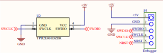

I want to use my MSPM1306L launchpad as debugger for my self made board where I am using MSPM1106L MCU.

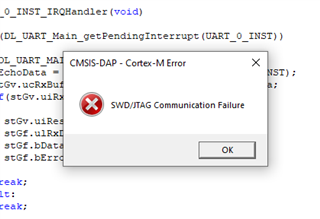

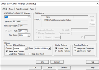

There are errors which will showing SW/JTAG error in Keil.
Need help on same.
Thanks in advance

Please share your error message and hardware connection.

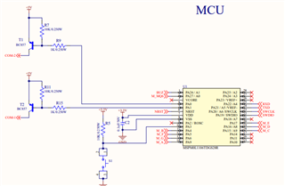

I noticed that you are using a 5V supply. Do you use a 3.3V LDO on your board?
OK, the hardware connection looks good. Could you also share the error message?

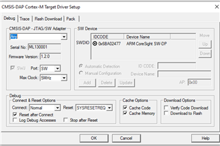

By the way, could you debug the launchpad well with the same project/software?
Please try to factory reset the device first.(SWDIO,SWCLK and NRST are needed)

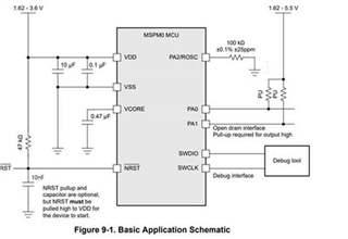

The capacitor of VCORE is needed. Without that MCU cannot start up.
For hardware design, please refer to the MSPM0 L-Series MCUs Hardware Development Guide (Rev. A)
