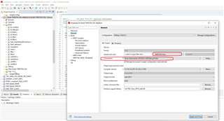

i want the CCS that is compatiable for this particular HDK so that i can execute all the examples and demos that are given in the halcogen software

Hi Amarchand,
Please refer below thread:
There won't be any dedicated CCS for HDK board,
If you are using HDK board then you should select the configuration as below:
The main thing is that you should need to select connection as XDS100V2 for HDK board, this is because this HDK board have XDS100v2 emulator on it.
