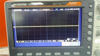

Actually i want to know how to configure the external clock for this MCU?
if you see in this picture there is no way to configure the external clock
so if it is available can you please mention how to configure and if not possible in sysconfig, or else can you explain what changes i need to do in coding to test the external oscillator.

    Now i am testing EXT_REFCLK0’ PAD this so for this i configured the
    clock configuration as
    GPIO configuration as
    i connect the pin with DSO
    Now my requirement is to test the clock frequency of reference clock in DSO so here 20Mhz i configured so same 20MHZ i need to observe in DSO
    1) so, can u please say how to use EXT_REFCLK0’ PAD this pin and can you say my approach is correct?
    2) if no can u say what is the way to monitor the Frequency of Reference clock in DSO which i configure in sysconfig?

  • Hi Akshit Thank you for your replay,
    1. I am Tested the pin CLKOUT1 Pin-72 in HSEC pin to DSO
    and i used this function SOC_rcmsetClkoutClock(uint32_t clkout0FreqHz, uint32_t clkout1FreqHz); but i am not getting the clock frequency in DSO
    in below u see i am expecting 25Mhz but i am getting only 2Mhz even though it will showing some noise.
    2. i am attaching my zib file below can you verify this and say suggestion i am not aware of this how to use
    1638.hello_world_am263x-cc_r5fss0-0_nortos_ti-arm-clang.zip
    3. Provide input to the EXT_REFCLK0 (HSEC pin 74) for the external clock, which mean i need to configure as XTALCLK in sysconfig?
    4. i need to test the Clock frequency of MCU in DSO also can you please detail explain the entire process step by step.

  • Hi Aakash,
    is there a peripheral which's clock you want to configure as External?
    Please refer to TRM: Table 6.28 to know which input clocks can be configured for which peripheral.
    XTALCLK and EXT_REFCLK0 are different.
    The reference clock can either be external crystal driver provided through ‘XTAL_XI’ pad or external reference clock provided through ‘EXT_REFCLK0’ pad. This selection can be provided using the TOP_RCM.PLL_REF_CLK_SRC_SEL register
    I highly recommend you to go through the TRM and Register Addendum, which will clear most of your doubts.
