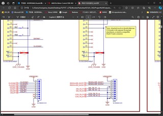

  • Hello
    ERROR: NIKON initialization failed
    This is pointing to some issue with hardware setup. This failure usually occurs when the encoder is not responding.
    Can you please share details on HW setup which you are using? Can you capture the signals using scope or logic analyzer and share? We want to check the digital TX, RX, TX_EN and CLK pins used for Nikon encoder interface.
    Since the customer sent us the HW setup and the signal captures, could you please check the attached file ?

  • Hello
    Thanks for sharing this. I had few questions:
    1. Can you please tell me which pin is being probed for DIO0 and DIO1 lines in each screenshot?
    2. What is the difference between NG case and OK case? Are the encoders same?

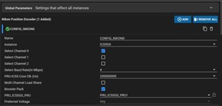

    3. What interface speed does the encoder support? Is it configured correctly in the SysConfig file of CCS project?
    Dhaval
  • Hi Dhaval,
    Thank you for looking into this. Since we got some feedbacks from the customer, please check below.
    J9 pin5 DATAP1               DIO3
    J9 pin6 DATAM1              DIO2
    J9 pin7 CLOCKP1            DIO1
    J9 pin8 CLOCKM1            DIO0
    Yes, it's the same encoder. Only software is different.
    See the attached files in the Nikon Diagnostics Evaluation_.xlsx for the difference.
    The encoder supports 4Mbps interface speed. They set 4Mbps in the SysConfig file.
