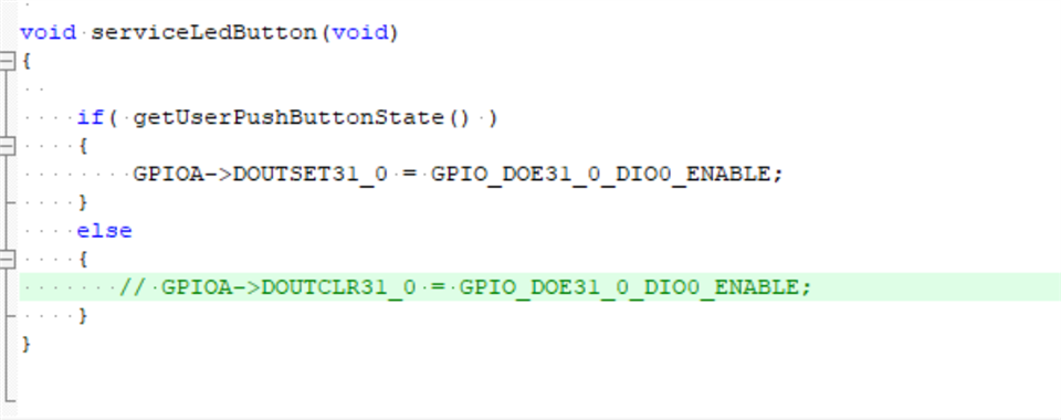

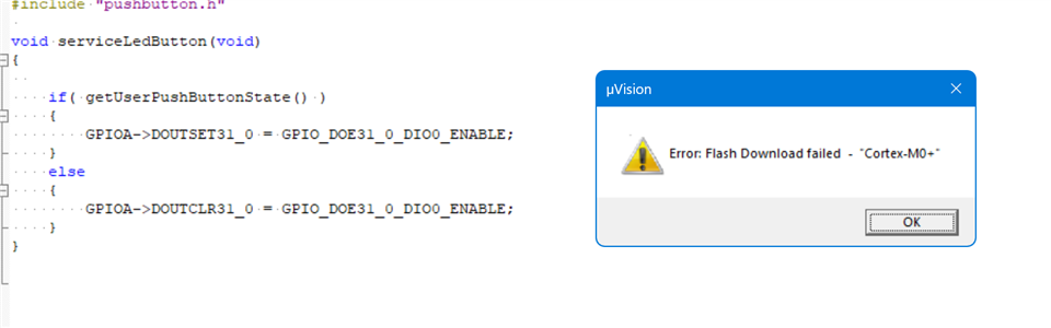

I am currently facing a strange issue in Keil uVision. When I write the code in a certain way, I am unable to flash the microcontroller. However, when I comment out the register DOUTCLR31_0
, I am able to flash the microcontroller. Please note that this strange behavior occurs with optimization level -O0.
I know I should ask Keil uVision directly, but I wanted to ask you about this strange behavior as well.
Ali

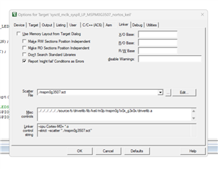

Hi Diego!
I removed R/O Base and R/W Base values and it worked
But I do not know why
Best Regards
Ali
Hello Vincenzo, Hello Ali,
It seems like removing the 0x2000_0000 region from the project itself resolved the issue.
Is there anything else that occurred that needs to be addressed? The reason as to why removing it would resolve any issue is the fact that MSPM0G3507 is the SRAM region of 0x2000_0000 is not intended to be used and more than likely an artifact from the ECC could have been causing an issue.

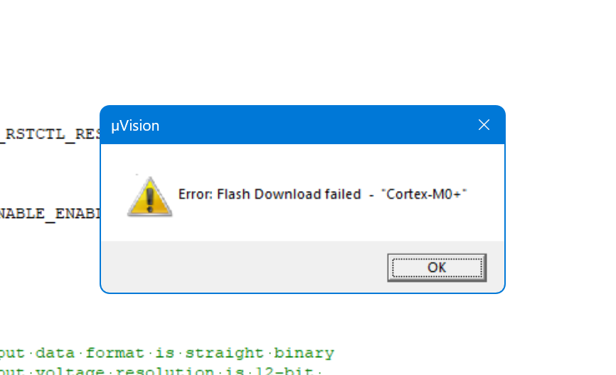

The issue that I am still facing is that each time I click of Build and then I want to load the programm to the FLASH I get this error I have to click of load again and then I can flash the microcontroller and I do not know how to solve this issue. So it would be helpful if there is a quick start documention for keil which shows all the Settings needed.
