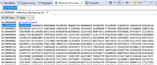

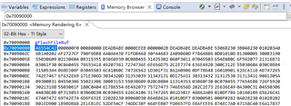

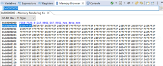

  • x509_cert_ptr returns value 0x1F instead of 0x30.
    Firstly we need to see if the appimage being flashes is correct or not, then the verification would be right.
    So, a typical HS FS appimage is going to look like this:
    So we need to first confirm from memory browser if the image is starting as following: 0x30 0x82 and so on.
    Can you do so and let me know?
    Vaibhav

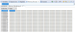

  • Hi Vaibhav,
    I checked the following 3 locations in memory browser, all showing 0:

  • Hi Vaibhav,
    Thanks for your reply.
    As the the values are all 0, does that mean the appimage flash is not correct?
    Kevin
  • 0x60000000, 0x60080000, 0x60088000
    You have looked at three of these locations.
    Can you please check the location where your hello world appimage is flashed?
    This should be a known offset at your end right?
    If it is one of the above three which you have checked, and then you are seeing all 0s, then there are two possibilities:
    1. The DAC is not enabled, hence you cannot see the flash contents.
    2. The DAC is enabled and the appimage is not flashed onto the flash part.
    To narrow down this problem, just before you check the memory browser, can you please go ahead and enable DAC in the following way?
    You can do so by calling:
    int32_t OSPI_enableDacMode(OSPI_Handle handle)
    After you have read the memory browser and checked for the contents then you can go ahead and disable DAC mode as follows:
    int32_t OSPI_disableDacMode(OSPI_Handle handle)
    Looking forward to your responses.
    Vaibhav
  • Hi Vaivhav,
    This is information printed by uart, with offset being 0x80000, hello word appimage should be flashed at 0x60080000:
    Also please be noted this function returns -1:
            status = Bootloader_uniflashProcessFlashCommands(&uniflashConfig, &respHeader);
    I tried to enable DAC before memory browser and this is what I got:
    Data seems do not match hello word appimage.
    Yours,
    Ellen
  • Hi Ellen,
    Yes, the hello world appimage you see after DAC enable is incorrect.
    To make sure that the appImage received over ethernet is correct, can you share the memory browser values at 0x70090000 as well.
    If this matches the hello world appImage, it means the appImage received is correct and flashing is the issue.
    Nitika
  • Hi Nitika,
    this is data from 0x70090000, is this data correct?
    Yours,
    Ellen
  • Hi Ellen,
    The MSRAM values of the appImage looks to be correct. So the data received over Ethernet is not the issue.
    Can you share the .json file of your flash and the example.syscfg file of your examples to understand what all has been modified on top of the original example?
    Nitika

    thank you for the detailed suggestion, here are my results:
    Clock divider: 4, Disable DMA, Disable PHY, mode: 1S-1S-4S, clock 133MHz/120MHz:
    Clock divider: 4, Disable DMA, Disable PHY, mode: 1S-1S-1S, clock 133MHz/120MHz:
    data at location 0x70090000 keeps consistent for all scenarios as:
    Can you please help and check the data?
    Many thanks!
    Yours,
    Ellen

    FYI, the value from flash as seen with 1s-1s-4s is incorrect and the value for 1s-1s-1s(hello world seems to be not flashed at all, and the bootloader image we need to confirm). Can you please check the hex dump of bootloader image and compare it with the 0x60000000 in 1s-1s-1s mode.
    Looking forward to your response.
