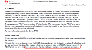

AM2432: The issue of implementing PBIST diagnostic measures for resetting.
Part Number: AM2432
Hi
We are conducting a security diagnostic based on the safety manual, which requires implementing the MSRAM2 - PBIST memory check and CBA9 - Error codes for invalid transactions diagnostics. We anticipate performing the PBIST diagnostic during boot-up; however, according to the manual's requirements, after completing the PBIST check, a reset is necessary. But executing this reset would result in an anomaly with the CBA9 diagnostic measure.
Could you provide guidance on how we should proceed with implementing these two diagnostic measures?
SDK:mcu_plus_sdk_am243x_09_00_00_35
Thank you
