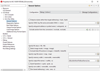

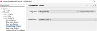

In order to create the .hex file product I set up the following options in CCS:
  1. Enabled Arm Hex Utility:
  2. Specified output file name:
  3. Set output format Intel hex:

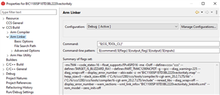

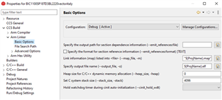

These are the linker settings:

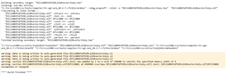

This is the building log:
I can’t understand the warnings.

      I think you need to use --romwidth 32 and --memwidth 32 flags so only one hex file is merged and produced. Refer to TI Arm Assembler user's guide for details. If this does not solve your problem, I will forward your question to our toolchain experts.
  • Hi Charles,
    thanks so much for the hint. This resolved my issue on the hex file.
    I'm still experiencing the warnings on the .elf creation:
    warning: section BIC1100SP18TD3BL2220vectoritaly.elf(.text) was padded by 2 to a size of 198400 to satisfy the specified memory width of 4
    warning: section BIC1100SP18TD3BL2220vectoritaly.elf($fill000) at 030906h overlaps BIC1100SP18TD3BL2220vectoritaly.elf(.text) (BIC1100SP18TD3BL2220vectoritaly.elf($fill000) incomplete or skipped)
    Have you any idea about it?
