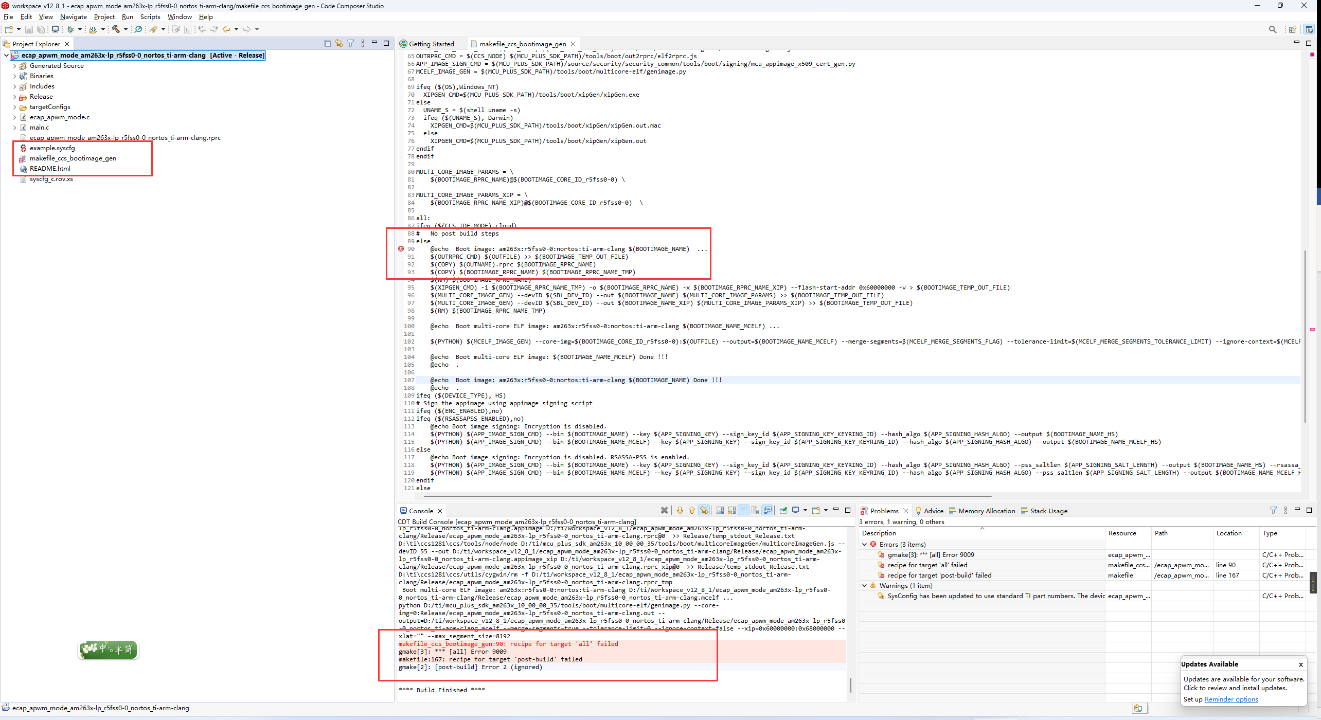

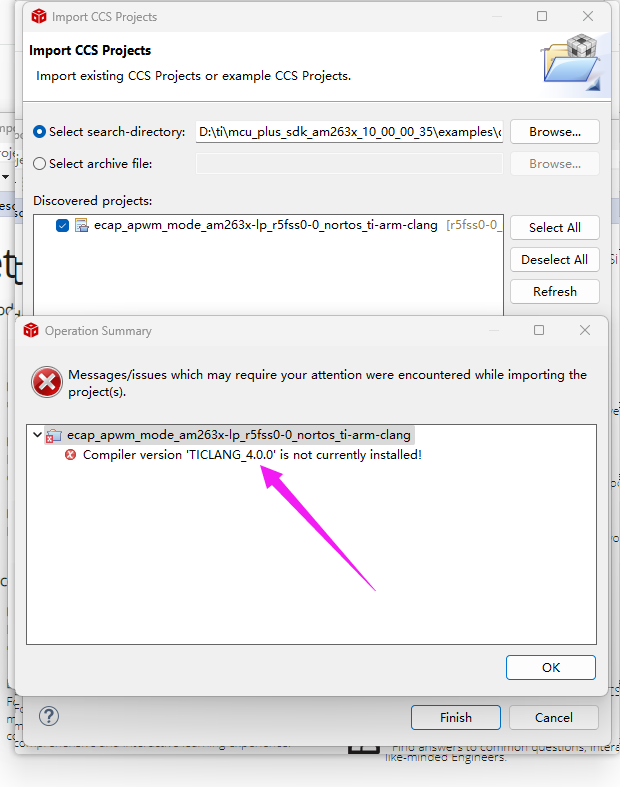

CCS Compiler error (v12.8.1)
In addition, the CCS ti-cgt-armllvm_4.0.0.LTS error has been resolved
Did it get resolved by just changing the CCS verison
Not by changing the CCS version, but by downloading the 4.0.0 compiler. This may be TI's fault, because the latest CCS12.8.1 has a 3.2.2 compiler built in, but the AM263x SDK10.0.0 uses a 4.0.0 compiler.
HI, Please also check the dependencies version required for other tools:
AM263x MCU+ SDK: Release Notes 10.00.00
Also CCS and SDKs are released separately, so sometimes the dependent tools can be different,
We mention to install the compiler separately:
Apologies for your inconvenience.
