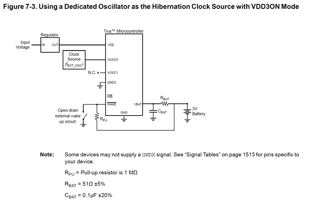

      Please also refer to TM4C129 for a reference circuit for hibernate mode.

    Regarding the circuit, I also noticed that the circuit for using a dedicated oscillator (our use case), which shows up in the device sheet right after the one you posted, has a 1M pullup.  So I would imagine that our 1M pullup should be ok as well.
