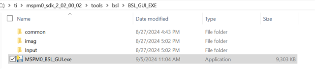

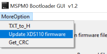

Try to update the firmware. It is possible to switch to DFU mode but the kit get lost, see screen shoot.
