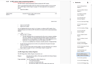

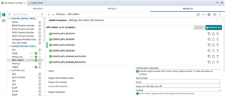

could you please share some kind of application note about configuring MPU ARMv7? please refer to the attachment.

The MPU region settings are specific to the R5F core.
If you look at the R5F TRM (4.3.21 Chapter ), you get the full details.
In generally, the R5F core has MPU regions with specific access permissions and users need to define what the starting address of the MPU region and size and access permissions.
