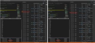

  • Hi Sal,
    Any updates please?
    During debug start and stop, debugger will insert some instruction to M0+ core.
    Maybe this takes some cycles.
    Even if you debug some single-cycle instructions, the result may be 4 systick cycles as well.
    Run 20 times mul, systick down count 26 times.
    Run 10 times mul, systick down count 16 times.
    Run 5 times mul, systick down count 11 times.
    For mul-steps debug, it will takes extra 6 systick cycles depending on this test result.
    I guess for single step debug, it will take 3 extra systick cycles.
    Here is the test demo:
    Instruction_MUL_Test_CycleTest_G3507.zip
    Hope this guide you well.
    Helic

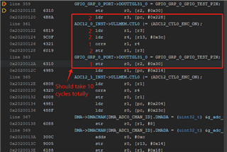

  • Hi Helic,
    Thank you for your explanation. It's quite helpful for me. I check my code by single step debug and find that almost all instructions clock cycles(with taking out the 3 extra clock cycles) conform to the information came from ARM's web site, but only the LDR instruction. The LDR instruction sometimes may takes 3 or 5 clock cycles, just as I mark in red at below screenshot.
    Here's my test code and please kindly help to figure out it.
    instructions_test_demo.zip
    Thank you!
    For the extra 3 or 5 clock, or the multi steps debug using breakpoint and resume function's extra 5 clock cycles,
    these phenomena should be caused by debugger, and it will take some time to confirm this.
    Helic
    This is normal because both Resume + breakpoint and Single step debug, need to insert some extra instruction to CPU.
    Helic

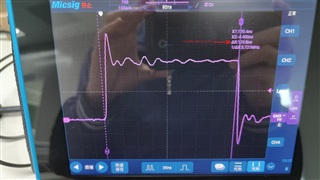

  • Hi Helic,
    Even I run the code without debugger, the LDR instruction sometimes still takes 3 ro 5 cycles. And here's my modified test code.
    instructions_test_demo_20250116.zip
    In this code, I add DL_GPIO_togglePins before and after DL_ADC12_enableConversions in line 361, then run the code without debugger. The positive pulse duration is 162.5 or 175ns, equals to 13 or 14 cycles. However, the expected cycle number is 10. According to the test result yesterday, I consider the extra 3 or 4 cycles is taken by instruction LDR R1, [R3].

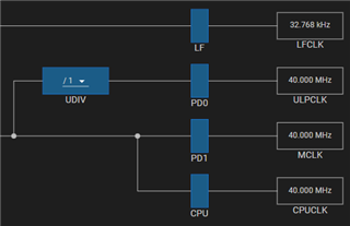

  • Hi Peter,
    I went through the previous reply and your test.
    For GPIO, it is accessed by ULPCLK and MCLK, as shown in the bus organization:
    This might cuase the timing difference for the test. The peripheral sometimes is access by different bus clock.
    So, maybe you can set your MCLK=ULPCLK=40MHz, and test it again.
    B.R.
    Sal

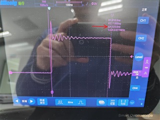

  • Hi Helic,
    Thank you for the update.
    I set MCLK=ULPCLK=40MHz and test again, but it doesn't help. The positive pulse durantion now is 325us, which is equal to 13 clcyes, 3 cycles more than expected. The instruction LDR R1, [R3] still takes 5 cycles, differs from other LDR instructions.
