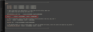

     Can you please increase the L2 memory in the linker.cmd file.
    With regards,
    Pradeep
  • Hi Pradeep,
    What should I do?
  • Hi Pradeep,
    I modified it in the mmw_mss_linker.cmd file. The modified content is as follows.
    /* Linker Settings                                                            */
    /*--retain="*(.intvecs)"*/
    /* Section Configuration                                                      */
    SECTIONS
        systemHeap :  {} > SBL_RESERVED_L2_RAM | MSS_L2
        .demoSharedMem: { } >> DSS_L3
        .l3ram: { } >> DSS_L3
    /* Memory Configuration                                                      */
    MEMORY
        L2_RAM : origin = 0x00800000, length = 0x00800000  /* 5120 KB */
    Is this correct?
    Thanks!
    -Meng

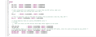

  • Hi Meng,
    If you are able to build your project then you successfully assigned more memory space to L2 in your linker. Normally we see these sections at the bottom of our linker command files from the SDK projects:
    this is where could make that kind of modifications.
    After these changes, do you still see the program will not fit in available memory error?
    Daniel
  • Dear Daniel,
    I tried modifying this part and looked up the manual and it can only be set to 960KB at most, but it still doesn't solve the problem
    Is there any other solution?
    Thinks!
    -Meng

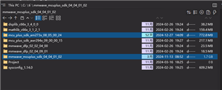

  • Hi Meng,
    is it possible for you to share your project? I would like to try to replicate the problem you are seeing.
    Another question. you said that the problem arose when you tried porting the project from  mcu_plus_sdk_am273x_08_05_00_24 to mmwave_mcuplus_sdk_04_04_01_02, correct? does that mean that the project from the more updated SDK generates a working linker file? can you grab that and port it as well to the project you are trying to build?
    Daniel
  • The two SDKs I mentioned are installed from mmwave_mcuplus_sdk_04_04_00_01-Windows-x86-Install.exe
    They should all share the r5f_linker.cmd in C:\ti\mmwave_mcuplus_sdk_04_04_01_02\mmwave_mcuplus_sdk_04_04_01_02\ti\platform\am273x, right?
  • Hi Meng,
    After a reinstall i am able to see the two projects you are talking about now. I am not sure what you mean when you say that you "ported" the mcu_plus_sdk_am273x_08_05_00_24\examples\networking\lwip\enet_cpsw_udpserver example into mmwave_mcuplus_sdk_04_04_01_02\ti\demo\am273x\mmw. These are two different projects in two different API packages, they don't share the same r5f_linker.cmd. That r5f_linker.cmd is shared amongst the demo projects in the mmw folder, but not used in the UDP server example project in the mcu_plus_sdk, this one uses the linker.cmd file located in mmwave_mcuplus_sdk_04_04_00_01\mcu_plus_sdk_am273x_08_05_00_24\examples\networking\lwip\enet_cpsw_udpserver\am273x-evm\r5fss0-0_freertos\ti-arm-clang
    I am attaching a comparison report between linkers in html format, let me know if you can't open it:

    with this in mind:
    • could you please tell me the steps you took to "port" the mcu_plus_sdk upserver project into the mmw demos? I am still trying to replicate on my side.
    • also feel free to grab the "working" linker.cmd file from the above example path and replace the r5f_linker.cmd one, or try to match the memory organization with the working one as closely and see if that causes any difference in the build. I am assuming the demo is a larger project overall so i don't expect a simple copy to work without some extra modifications anyways. but if you can help me replicate I will be able to understand where the problem is coming from better
    Daniel
  • Hi Meng,
    the referenced post doesn't use the same software package and contains different definitions from what you are trying to build, can you please share the files that you modified so I can try to run this on my side? above thread modified the makefile and the .mak file but if you modified anything else please attach as well.
    Can you also please explain what do you mean by porting the udpserver example form the mcu_plus_sdk into the mmwave demo?
    Daniel
  • Dear Daniel,
    First, to answer your question about putting the udpserver example in mcu_plus_sdk into the mmwave demo, the mmwave demo does not contain the content of enet communication, and we are using the DT83TC812 Ethernet chip, so I first use the udp_server demo in mcu_plus_sdk to modify the chip configuration, so that it can successfully send and receive UDP data in mcu_plus
    _sdk, and then add the modified code to the mmwave demo
    Here are the changes I made to make it compile without errors after adding the ENET code:

    There should be a linker command file under C:\ti\mmwave_mcuplus_sdk_04_04_01_02\mmwave_mcuplus_sdk_04_04_01_02\ti\platform\am273x called r5f_linker.cmd.
    It looks like it is not allocating the whole L2 space. could you open that file and change the length of the MSS_L2 section from 0x000C8000 to 0x000F0000 on line 107:
    Once done please clean and try rebuilding the project, the additional allocated memory should be enough to cover the hole from the error you were getting before.
    Daniel
