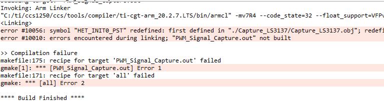

  • Hi Jagadish,
    Sorry for late response.
    My working around is below step by step:
    I downloaded your capture project and imported it to my workspace. Then I compiled this code.
    I got a redefinition error for some code blocks during compilation:
    So I excluded the Capture_LS3137 folder from the compilation. After that I was successfully compiled codes. My setup as below:

  • Hi Ali,
    I tested the example, and it is working as expected only. Let me explain what are the steps that i followed.
    1. First i downloaded the capture example project in from our previous thread.
    2. When i build this project then i got the build error that you are talking about:
    I rectified this error by excluding below file in the project:
    Once i excluded capture.c file in the source directory then i don't see any other build errors in my project.
    3. Now i tool another board called TMS570LC4357 Launchpad, using this board i am generating a PWM signal with 50% duty cycle and period of 100uS, and i connected this signal and along with its ground to the N2HET1_30 pin of the TMS570LS3137 HDK board.
    4. And then i run the both the codes and verified the period, frequency and duty cycle in TMS570LS3137 board and i got the below readings:
    So, the code is working without any issues from my end. Try to follow the same steps in your end as well.
