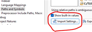

  • Hallo Tushar
    Thank you for your really quick response.
    Ok, I have to import the empty project for the R5F0_1 core. Then I copy the code into my system project, and add the sysconfig.
     But there is one practical question remaining.
    The sources of the cia402 demo project will be created as a link in the ccs project.
    How can I import the links for the sources and the paths/variable settings from the source project into my empty project.
    Unfortunately, Import Settings does not work. No settings to import are displayed.
    What can I do?
    Alexander
