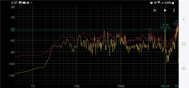

When the motor rotates, I hear high-frequency sounds in the 5khz and 10khz frequency range. What is this?
And could this feature possibly cause noise?
MCUs from other companies with the same motor do not produce such high-frequency sounds.

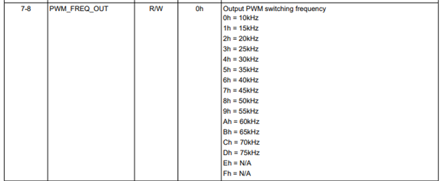

    This is off-topic, but Table 5-28 on page 36 of the MSPM0 Sensorless FOC Tuning Guide (Rev. B). According to CLOSED_LOOP1 Register Field Descriptions,
    Number 2 is said to be 20kHz, but the actual C:\ti\mspm0 sdk_2_03_00_07\examples\nortos\LP MSPM0G3507\motor_control_pmsm_sensorless_foc\sensorless-foc DRV8329. If you check configTables.c in the example, number 2 is 16kHz.
      -> i Think that must be fixed.
    Anyway, back to the point, I am using 20kHz.

    I'll also send you some information about the sound I'm hearing.
    High_frequency.m4a
    I will also send you the results taken with a noise meter.

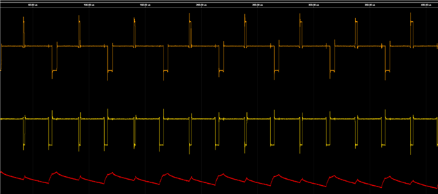

  • Hey Donguk,
    Could you capture the waveform at 100us per div, if there is an motor commutation issue leading to noise then if should be present every 100us (10kHz)?
    Akshay
  • Hi Akshay,
    There is no noise occurring at 100us cycles on the 3-phase voltage/current waveform.

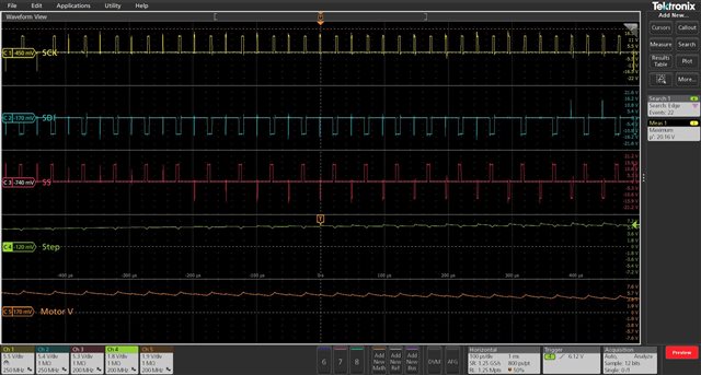

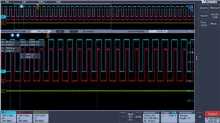

  • Wait a minute, our product's PWM cycle is 20kHz, but looking closely at the waveform, the PWM signal comes out at a cycle of 40kHz, and the waveform seems to be the same every 20kHz. Could these pulses that come out in different shapes every 20kHz be the cause of the sound?

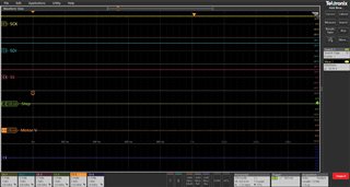

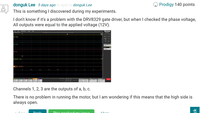

  • This is something I discovered during my experiments.
    I don't know if it's a problem with the DRV8329 gate driver, but when I checked the phase voltage, All outputs were equal to the applied voltage (12V).
    Channels 1, 2, 3 are the outputs of a, b, c.
    There is no problem in running the motor, but I am wondering if this means that the high side is always open.
  • Hi Donguk,
    When the PWM frequency set as 20kHz, there current ripple frequency will be twice as the PWM frequency, due to it is 7 step SVPWM, which means that the current will switch twice within a PWM cycle.
    Normally, these two waveform need to be same. While, DRV8329 is a single shunt solution, so it will do phase shifter to reserve enough current smapling window to get both phase current. And yes, this migh bring additional noise. [Updated: I think this only occurs at high speed.]
    My question is that, for the other board, is its shunt resisitor also single shunt? And, is its PWM frequency is also 20kHz?
    Sometimes, the deadtime will also make the impact on the noise, so is there any difference on this parameters setting with these two different board? [combine the software setting and gate driver setting]
    Generally speaking, for noise issues, in the software part, the tuning method is to “Adjust the current loop bandwidth to reduce the current response speed (equals to decrease kp/ki of the current loop), which can suppress partial noise.”
    By the way, this is a typo in the tuning guide, we will fix it in future version.

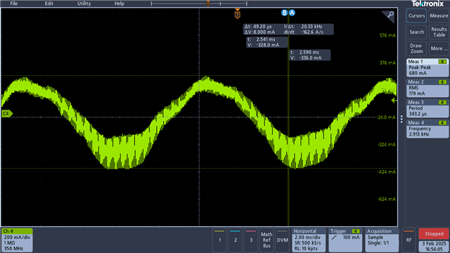

    This is the current waveform shape of a third party.
    This is the current waveform shape of the Ti MCU.
    This is the result of being powered by the same 14V/0.6~0.8A DC power supply, and as shown in the figure, the amplitude and shape are quite different.
    In my opinion, Ti's current waveform is better, but the gate waveform and the audible noise are not as good as third party.

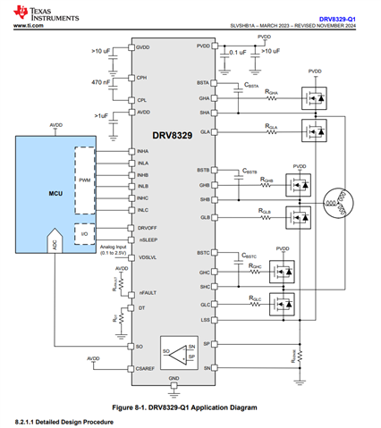

  • If you would like to see if there is a hardware problem, please refer to the circuit I emailed you on January 16th.
    If you have any concerns about what might be causing problems with the hardware design, please respond via email rather than the forum.
    We designed the hardware based on the following reference circuit:
    -> DRV8329-Q1 4.5 to 60V Three-phase BLDC Gate Driver datasheet (Rev. A)
