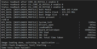

1. Run ospi_flash_diag example (C:\xx\mcu_plus_sdk_am263px_10_01_00_31\examples\drivers\ospi\ospi_flash_diag\am263px-cc\r5fss0-0_nortos) without bootloader (DEV_BOOT mode). Result: This runs OK, I can see same UART output as example.
2. Run ospi_flash_diag example with sbl_ospi.release.tiimage under "C:\ti\mcu_plus_sdk_am263px_10_01_00_31\tools\boot\sbl_prebuilt\am263px-cc\". Flash sbl_ospi with offset 0x0 and ospi_flash_diag with offset 0x81000 as intended. Result:

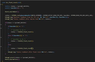

3. Debugged bootloader in i2c_flash_reset, with code below. Debug output from the EEPROM read returns 0, and so the default function goes into TCA6416_Flash_reset, which is incorrect as that chip was only present on the earlier version  of the ControlCard (version PROC159E2). There's a question why the EEPROM does not return the correct value for boardver (0), but this this code probably needs updating so the default function is TCA6424_Flash_reset.

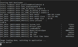

4. Created custom bootloader with this step from #3 above. Flash this using UniFlash together with helloWorld application. Run application from OSPI. Result: serial output is OK. (so custom bootloader is OK, OSPI load from boot seems to work also)

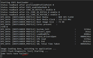

5. Flash custom bootloader and ospi_flash_diag example from #1. Now, we get one step further as we enter application, but fail on the first step of communicating with the flash chip from there.
This implies we fail on execution of the first OSPI_norFlashReadId(). I have not continued debugging but it would seem like there is something fundamentally wrong with OSPI modes/sequencing or similar. Could a member of TI go through this last step and verify the OSPI SBL works OK with the Flash Diag example?

    Apologies you had a face this issue, we identifued this bug lates last week and we are working on making the updated release to fix it.
  • The issue is happening due to boards version mismatch, As the new revision of Control card has similar flash reset mechanism as am263px-lp.
    So for the meanwhile you can use the following workaround:

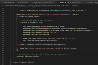

    With this reset now connected, the custom sbl runs as expected. However, when I try to also flash in the example ospi_diag application, I was getting the same issue as before, where the Application was not running:
    I noticed there were quite a few different settings for OSPI between the ospi bootloader and flash diag application. For example, the ospi clock freq is set to 80MHz as opposed to the 133.3 MHz in ospi bootloader, mode is 1s-1s-1s vs 8d-8d-8d etc.
    I have tried to mostly align ospi settings but think the ospi flash diag example contains some repeated secondary initialisation parts of the OSPI module, so expect a resource lock or similar is causing a problem.

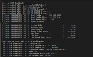

    To resolve this, for testing I can add a flash chip power cycle on start of application boot, resetting the ospi interface. This allows the flash diag example to proceed as expected, booting from OSPI.
