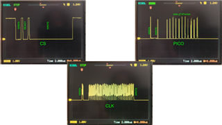

  • Hey Bruce,
    Well, I separated the WREN and still not working using Chris suggestion (from his post).
    Than, I started to do some tests which I'm repeating the same code I used to write to read (except I'm using the gTxDummy).
    I'm attaching one figure, I "think" I can see the writing part of the process but not the reading.
    I'm attaching my code here, it would be great if you could run and have your impressions about it. You can keep the syscfg file from the example, you only have to add a timer (with interruption every 1 second).

    I'm doing more tests and I found some interesting things using breakpoints.
    First time I run SPI_send(), write and read is working fine (below figure), my gRxPacket is the same as my gTxPacket (line 191).
    Second time I run SPI_send() I'm storing "trash" in my gRxPacket (line 131). I know, it is stupid. I create a gRxTrash to receive these data. It is fixed now.
    Most intriguing is that after the first run it does not work anymore. I don't see the CS, CLK, and POCI for the reading part. The oscilloscope data looks like the figure I sent before.
    Please, could someone give some help to try to fix why it only works once?
    Thanks again,
    Andrea
