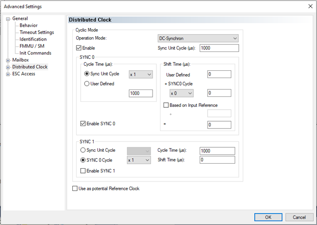

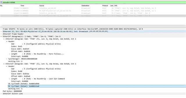

I am measuring sync0 and sync1 signals on J73 and J7.5 on AM243-LP board.
Sync0 cycle time appears to be 250 us on oscilloscope - this matches my expectation.
Sync1 cycle time appears to be 2 times the cycle time - this is problematic in my eyes.
Here the value of some CoE objects:
For your information: I see the following values with another tool in real-time.
SM output parameter is 0x1C32:01 is 0x02 and 0x1C32:02 is 250000, and
SM Input parameter is 0x1C33:01 is 0x03, and 0x1C33:02 is 250000.
Could you please help me understand why sync1 frequency is 500us instead of 250 us?
