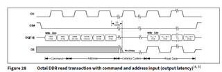

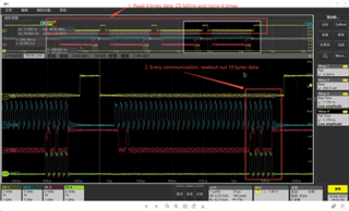

We tested the flash-read waveform of OSPI DQs/DS/CLK Pins on 8d-8d-8d mode, and found it's very inefficiency. Is where any way to improve at present and any plan to update SDK?
#1. Read x consecutive bytes, will trigger x times transfer instead of 1 time
#2. Every communication, although only read 1 byte, actually triggers 10 bytes CLK.
Question #1 and #2 show in the below picture: waveform of read 4 bytes from ospi flash.
In fact, one time ospi transfer is enough.
# 3. Default dummy Cycle is tow long at low frequency(25MHz). When 25MHz, 25->6, 11->0 is enough。
    I need to understand what this means, I am assuming so it could be either of the following two cases:
    Suppose Source Offset values in 8 bit unsigned int format is as follows: 1, 2, 3, 4, 5, 6, 7, 8, 9, 10, 11, 12, .......
    1. First case could be that you want to read 1 byte, which is the value 1, but you end up seeing the values 1, 2, 3, 4,..., 10 on the waveform.
    2. Second case could be that you want to read 1 byte, which is the value 1, but you end up seeing the value 1 read 10 times on the waveform.
    I am assuming you are performing a direct read operation as you are using a NOR Flash part. If yes, then for transfers of size > 1 KB DMA is used, else for transfer less than 1 KB, lets suppose for 32 bytes, you are seeing the 32 bytes getting transferred 32 times instead of 1 time on the waveform?
    First case.
    Yes,  debug and found it't just  a memcpy(). And seeing 32 times transferred for 32 bytes.

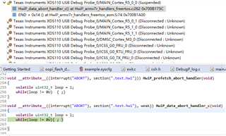

    And I've run into a new question:
    Import "Hello world" from SDK10, enable flash in sysconfig, Flash_read() 64 bytes failed, EVM board debug log as show the in below picture, while SDK9 is OK. How to fix this?

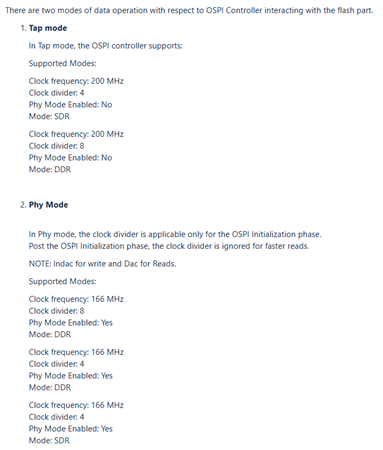

    Also, please look at the following supported combinations:

  • The flash read fails or the flash initialization fails?

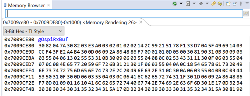

    Debug and found than crashed when calling memcpy with 64 bytes, log show at here:

  • Hi Vaibhav,  I found that it can work if delete Flash config in "MPU Armv7" (CONFIG_MPU_REGION4), include ospi phy mode and read 64 bytes. What's the basis?
  • I found that it can work if delete Flash config in "MPU Armv7" (CONFIG_MPU_REGION4), include ospi phy mode and read 64 bytes. What's the basis?
    Can you still read if you remove config_mpu_region4 and do not enable phy mode?
  • Can you still read if you remove config_mpu_region4 and do not enable phy mode?
    Yes
  • So just removing this configuration helps.
    Well, by default when you open one of the OSPI applications which comes with the SDK we see that this region config_mpu_region4 is not defined, so that speaks for itself. But as a safe measure I will try to include this region in my working example and check if it fails for me as well. If it fails, I can gather some explanation and let you know.
    Thank you for your patience.
    Vaibhav
  • OK, looking forward your update.
  • Hi Liang,
    I just checked that when you configure the region from 0x60000000 to be cached, the the Processor reads from the cached memory and will not be able to fetch the most recent data from the flash, thus leading to problems like data abort which you were seeing.
    So please go ahead and remove the configuration.
