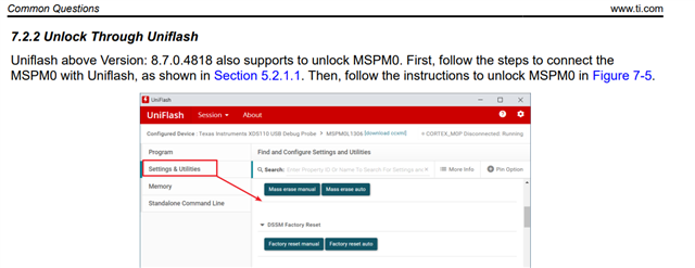

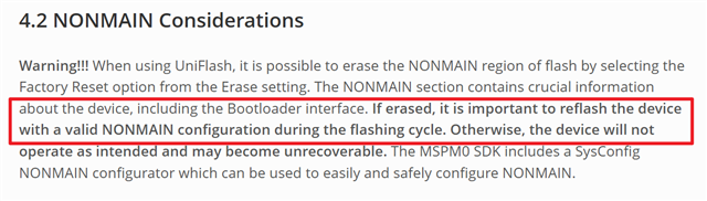

if erase method select: Erase MAIN memory only, after progaming done. the next time using UniFlash also could connect and progam MCU.
but, if erase method select: Erase MAIN and NONMAIN memory, after progaming done, the next time using UniFlash, couldn't connect MCU. and CS also couldn't connect this MCU.
how could I do for this MCU?
