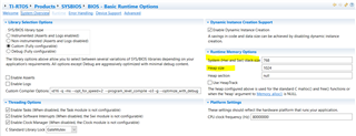

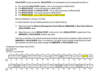

    You seem to have a usage fault that is elevated to a hard fault. The usage fault is somehow due to the processor attempting to execute an undefined instruction.
    Usage Fault. A usage fault is an exception that occurs because of a fault related to instruction
    execution, such as:
    – An undefined instruction
    – An illegal unaligned access
    – Invalid state on instruction execution
    I will suggest you use the ROV to see if you have any memory problems and increase the system stack and heap to see if that makes a difference. Maybe you can first double the amount of both the system heap and stack. If the problem goes away, you can fine tune for the best amount for heap and stack allocation. See below where you can allocate the runtime heap and stack in the .cfg file.
    Please also refer to the below two posts on how to debug exceptions for TI-RTOS app.
