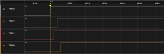

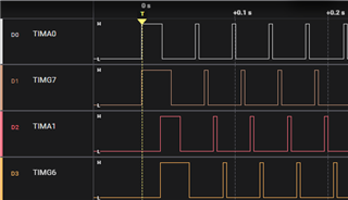

I am working setting up some center aligned pwm signals, and are setting it up for using the shadow compare feature, to only update the compare value on a ZERO event.
It works fine, but there is one oddity:
The very first duty cycle seems to have an arbitrary length that I cannot seem to change. After the first pulse, things work fine, but no matter which order I write the registers, the first pulse seem unaffected.
Here's a screenshot with an initial duty cycle set up for 10% showing the issue:

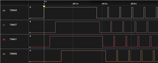

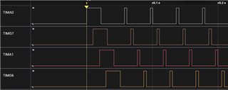

    Here's the current setup, engaging shadow compare/load BEFORE setting load/compare values:
    And here, AFTER setting load/compare values:
    I can't quite figure out why the pins stay high that long in the second image....

    I will look into this code first. Just for check is it possible to directly provided the project here?
    Cash Hao
  • As you can see in the code, I am currently testing things out, using the systick to generate an interrupt to change load and compare value.
    Interestingly, if I dont make any change to those, but only stick with initial values, and enable shadow-registers after setting load/compare values, I get this;
  • Interestingly, I think I found something that works, in these steps:
    1) Set initial compare and load values.
    2) Enable shadow functionality.
    3) Set the initial compare and load values AGAIN.
    I just wonder if it makes sense that I have to set them both before and after enabling shadow register?
    Well, I do not think it requires to set the initial compare and load values two times. Let me run some tests tomorrow and check on this behavior.
    Cash Hao
  • It's true that TRM Table 27-16, for entry "0", doesn't mention "stored in a shadow compare register". It never occurred to me that it wasn't set (immediately) Through the shadow register.
    Good catch.
    I do observe this behavior on my side.
    The issue is gone when I set the CC value again after enabling shadow function. No need to set load value again here.
    So, the current solution would be set the CC value twice before and after enable shadow function.
