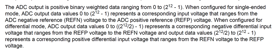

  • Changing this has no effect on the ADC sampled data, The sample data is same as the image provided earlier. How to sample the negative samples through the ADC. As currently, I am only able to get positive samples but those also not of proper waveform .

    Could you let me know what is the peak-to-peak voltage of the sine waveform you are trying to sample using ADC?  Please note that in the single-ended mode ADC results positive binary weighted data ranging from 0 to (212 - 1) and the range of the input voltage is from REFN to REFP, that's why you are only observing the positive samples, you might have to use differential mode for this:
    Another thing you can try is to give your signal a DC offset, so that the entire signal comes in the positive voltage range of REFN to REFP, while plotting the graph you can subtract the same offset from the ADC sample values.

    Currently i am using Keysight Signal generator with amplitude of 1dBm and frequency of 10kHz. How to configure the differential mode and generally differential needs signal on two pins. How to configure for the same .
    How to configure for the DC offset ?
    This might not be possible if you are using TI EVM, as you need to apply negative reference voltage for this on REFN. In the EVM REFN is connected to ground.
    You can apply the offset using the signal generator itself.
