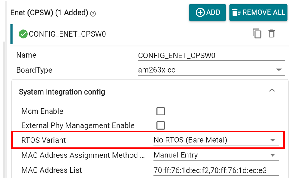

  • Hi Kavaskar,
    Can you confirm that your sysconfig Enet settings match the example you are referring to.
    Specifically, can you check the RTOS variant selected in Enet (CPSW) > System Integration Config, it should be set to 'No RTOS' - this will add the function EnetApp_initPhyStateHandlerTask in the auto-generated file ti_enet_open_close.c.

  • Hi Nitika,
    Thank you for your response. The build was successful, but the .tiimage file was not generated.
    Could you please let me know if I might have missed something?

    https://e2e.ti.com/cfs-file/__key/communityserver-discussions-components-files/908/8422.makefile
    Nitika
  • The .tiimage file has been successfully generated. I’ll test the driver next and keep you posted.
