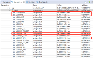

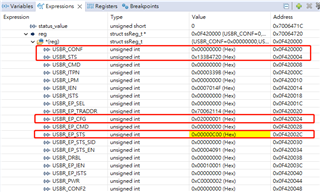

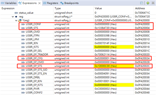

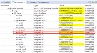

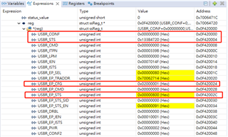

  • Hi Tushar,
    First, I checked the circuit board where the tiny USB could not use full-speed mode.
    1. High-speed mode connected to the PC successfully – recorded the registers.
    2. Full-speed mode did not connect to the PC – recorded the registers.
    I found that the values of the registers were not constant, so I recorded them four times.
    Next, I checked the circuit board where the tiny USB could successfully use full-speed mode to connect to the PC
    Please help me verify these registers and provide some solutions so that I can make the problematic circuit board successfully use Full-Speed mode again. Thank you.
    Bolt
  • Hi Bolt,
    I think the register values are continuously changing when you have captured it. I was asking to have a exact register value when the error happens but looks like it is not possible to capture this using Memory Browser view in CCS.
