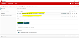

    5. After both boot_serial_uart_flash_MSP_EXP432E401Y_nortos_ccs and buttonled_MSP_EXP432E401Y_tirtos_ccs are built, I use the Uniflash to load both the .out files simultaneously.
    6. After both the bootloader and the application are loaded to the flash, I can press either SW1 or SW2 on the LaunchPad and I can see either D1 or D2 LED blink. I DO NOT see any issue where jumping from the bootloader to the application will create any faults.

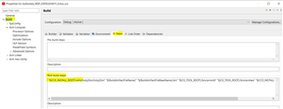

    4. I generate the binary file for buttonled_MSP_EXP432E401Y_tirtos_ccs as in buttonled_MSP_EXP432E401Y_tirtos_ccs.bin. You can insert the below line to try out yourself. The post-build command is:
    "${CCE_INSTALL_ROOT}/utils/tiobj2bin/tiobj2bin" "${BuildArtifactFileName}" "${BuildArtifactFileBaseName}.bin" "${CG_TOOL_ROOT}/bin/armofd" "${CG_TOOL_ROOT}/bin/armhex" "${CCE_INSTALL_ROOT}/utils/tiobj2bin/mkhex4bin"
    5. Instead of using BSL_Scripter.exe, I use another tool that takes the bin file for USB DFU. The tool I use is called LM Flash Programmer. You can find this tool at https://www.ti.com/tool/LMFLASHPROGRAMMER
    6. After the usb bootloader is running, it should find Device Firmware Update. Make sure you don't select a different DFU devices so you don't accidently upgrade the wrong DFU device.
    7. Provide the .bin file and set the address to 0x4000 and then hit the Program button. Once it finishes, I can see the LED blinks when I press the SW1/SW2 button on the LaunchPad.
