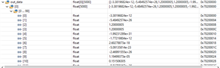

The problem is not all values get sets to 0, if I pause the application and try to manually set the array values to 0, it still doesn't work! I wonder if that is a silicon issue? do I have a bad SOC? or a configuration issue?

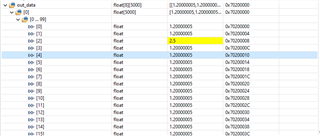

    3. In the main function, add the for loop to populate the "out_data" buffer. (instead of 0.0f assignment, I assigned 1.2f values, since compiler will automatically assign "0"). See the below screenshot for the populated out_data buffer.
    4. On running this code, I am able to properly update the buffer values (manually from expressions window as well, see the below screenshot)
    I need your help in reproducing the issue. Can you please share your CCS Multi-core project or the steps to reproduce this issue?

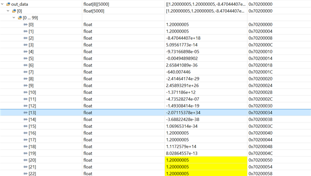

    I replicated your steps, and I still get that same error
    as you can see some values got updated to 1.2f and some didn't! attaching the empty project example.
