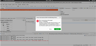

Hi there,
How can I download application to the RAM of the second sitara AM243x. I have two AM243x in the daisy chain configuration to XDS110v2. I can download application to the first one.
Then I used a modified target configuration (set as active configuration). However, I cannot connect to the second via jtag.

  • I have some problem to update the target configuration file, which I set as active configuration  and bypasses all items for the first sitara am243x wherever possible.
  • Hi Shen,
    Please make sure you have bypassed the first AM243x SOC and are trying to connect with second AM243x SOC.
    Also make sure the second AM243x SOC is initialized properly with SBL binaries and the boot mode configurations are also correct.

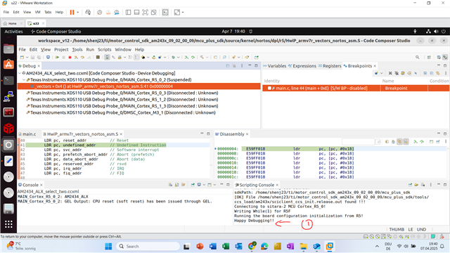

  • It is my end of day.
    The result above is obtained in the debug view, where target is R5 0_2 (which is r5f core 0-0 0f sitara-2).
    I repeated it in a different way.
    I use the target Config file for daisy chain where sitara-1 is bypassed and sitara-2 not bypassed
    DIRECTLY in load_dmsc_hsfs_sitara2.js (a different version of this same named file)
    This way, I directly executed the script in script console: see output on bottom right. I am not trusting the output - although gui showed that the soc initialization binary was being downloaded to target, I never saw it executed.
    I then downloaded led example to r5f-core0-0 by adapting the same script (just replaced the binary in the same script) and led is not blinking on sitara-2 while it should be.
    Sitara-1 is always working.
  • Hi Jinlong
    The output of the script looks okay. Have you also seen some logs coming on the CCS console?
    Also can you please tell, by gpio_led not working do you mean the example does not execute? Are you seeing any error messages?
    Please share error logs if any. Or is it just the led not blinking?
    Tushar
  • This is the console output:
    MAIN_Cortex_R5_0_2: GEL Output: CPU reset (soft reset) has been issued through GEL.
    I made some progress in-between. My program apparently is successfully loaded to RAM of sitara-2.
    However, run() seems not working.
    // Halt the R5F and re-run.
    dsMCU2_0.target.halt();
    // Run Synchronously for the executable to finish
    dsMCU2_0.target.run();
    I am checking disassembly and entry function. c_init00?
    About led, it is the next step which is being used as extra experimental method to check if soc initialization has worked. With the progress aforementioned, we can forget led for now.
