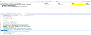

Hi,I am debugging the TMS570LS0714 flash with F021, and I found that the Fapi_initializeFlashBanks function returns the error Fapi_OtpChecksumMismatch.
I have set SYS_CLK_FREQ to 100MHz, RWAIT to 1,and EWAIT to 5.
The code as follows:
status = (Fapi_initializeFlashBanks((uint32_t)SYS_CLK_FREQ));
if (status == Fapi_Status_Success)

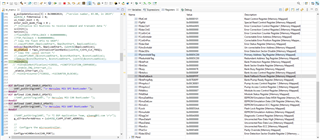

I have also noticed that FallbackPower mode register does not try to activate bank0 and bank 7, even though when i hardcode it to activate both of them
When I try to see FBusy register, it shows both of the banks are not implemented.
Is there anything Im missing while initializing the flash?
