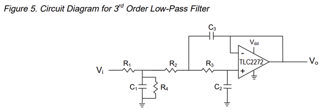

    2) Please recommend an IC chip that we can use to convert the APWM signal to analog signal?
    Please refer to the app note below:
    https://www.ti.com/lit/spra490/
    It provides details on implementing a 3rd Order Low-Pass Filter that can be used to convert discrete PWM signals to a continuous analog voltage.
    Zackary Fleenor

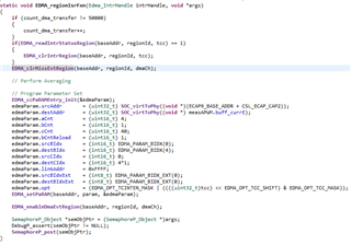

  • Hi Akshit,
    I have configured the EDMA in EVENT mode so that the DMA transfer is triggered upon an ECAP event. The ECAP capture registers are copied into a buffer, capturing 40 duty samples before I average them. I want the DMA transfers to be continuously triggered as long as ECAP captures the events.
    However, I am seeing the DMA transfers happening only once after I start running the code.
    Could you please tell me how to set the DMA transfers to be continuous?
    Also, did you get a chance to share your project where I can access it from?
    Thank you!

  • hi Akshit,
    Thank you for your response.
    My code is set up exactly as you describe above. However, I'm still not able to do continuous DMA transfers.
    Here are my observations -
    1) when LINK = 0x4000, after first DMA transfer happens, the execution enters ISR. At this time, register readings are EMR=0, EER=1, IER=1, IPR=1.
         Writing ICR=1 does not clear IPR.
          ISR keeps getting triggered without any new DMA transfers (buffer does not update with new duty cycle) as IPR remains set to 1.
    2) when LINK = 0xFFFF, after first DMA transfer happens, the execution enters ISR. At this time, register readings are EMR=1, ER=1, EER=1, SER=1,                 IER=1,  IPR=0. Calling EDMA_clrMissEvtRegion() does not clear EMR. I reset the destination address and re-enable the DMA channel again in ISR, but          the execution gets stuck in SemaphoreP_pend() loop and I do not see ISR triggering after that.
    3) My project compiles fine but while debugging I'm unable to step into EDMA SDK APIs. I have checked my project properties and it is pretty similar to the example projects. Could you tell me if I might be missing any configuration here?
    Could you please try to reproduce this issue on your end and let me know how to resolve it?

  • Below is my ISR set up -

  • Hi Akshit,
    I had initially programed the edmaParam.linkAddr with the address offset of the same parameter set as I thought it will automatically update the PaRAM set of a channel for continuous transfers. However, that did not work for me. It only helped in avoiding the EMR bit set.
    Re-programming the parameter set, re-requesting the channel and re-enabling the transfer after every block transfer worked.
