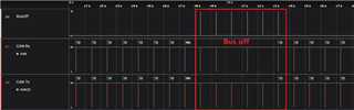

    This test result is not from this demo, but you can refer to this test result:
    Demo enables CAN bus off status changes interrupt: BO
    And will detect Bus off status register in CAN BO interrupt:
                    DL_MCAN_getProtocolStatus(MCAN0_INST, &gProtStatus);
    Then in main loop, CPU will restart CAN when
                    if(CANBusOff == 1)
    and set debug pin to high during the MCAN restart.
    Test result:
                    ID from 0x00 to 0x06 is send successfully, total 8 frames.
                    ID from 0x07 to 0x0C is failed to send, due to CANH and CANL is shorted.
                                    Total 5 frames is failed to send and CPU try to restart CAN 6 times.
                                                    You can see busoff pin toggle 6 times, the last one restart CAN successfully.
                                                    void MCAN0_Restart(void)
                    Then after release CANH and CANL’s shorted, CPU run CAN restart successfully.
                    ID from 0x0D to 0x11 are successfully receive by CAN analyzer, total 5 frames.
