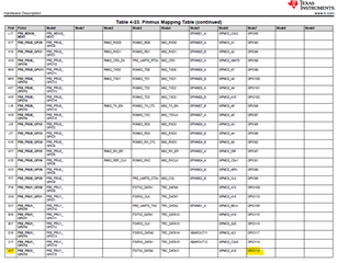

I am using AM263x_CC board, and I am trying to configure a GPIO Input as an Interrupt, but unable to find it's related XBar Output and XBar Instance in Sysconfig.
Here is the pin no: A17
can you please provide necessary inputs?
Also can you please share any Document having these XBAR related information for each pin ?
Thanks!

    in MCU XBar part-  is GPIO Input Xbar and Xbar Output Map right values as I see in Datasheet for A17.

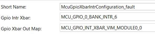

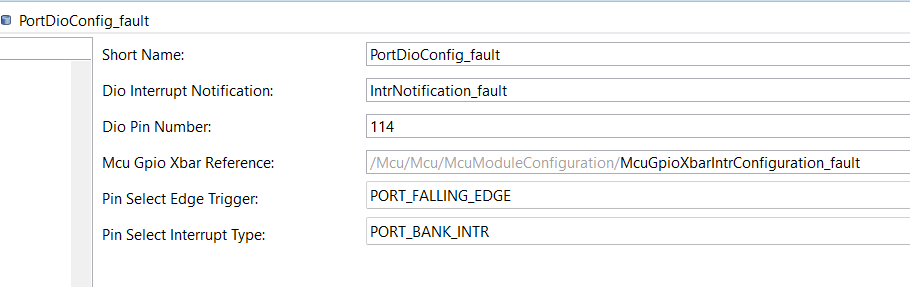

    Following are the configurations in Vector Davinci configuration (for Xbar output and instance, as per corresponding GPIO114 pin)
     MCU module : McuGpioXbarIntrConfiguration
    Port Module : PortDioConfig

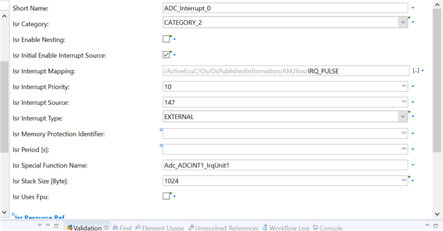

    Also added OsIsr configuration in OS module.
    Can you share the screenshot for the same?

    2. Can you share the screenshot for the same?
    Ans : find the OsIsr configuration of OS module.
  • Can you check the below 2 points at your end?
    1. You have selected "Isr Initial Enable interrupt sources" in the above config. I believe this generates an API Os_InitialEnableInterruptSources() which would have to be called at your end in code after the OS starts and before any interrupt occurs. Can you check if you have done the same?
    2. If yes, you have mentioned Category_2 as ISR category here. Can you confirm if you have configured the same in the module tab as well?
    3. Please confirm if 142 is the correct source number.

  • Checked for the mentioned points.
    1. Os_InitialEnableInterruptSources() getting called.
    2. In port module selected the type of Interrupt function as CAT2 ISR.
    Is there additional setting required at any other module level?
    3. For source number 142, referred the TI Technical reference manual (and also checked with example code present in sdk).
    For A17/GPIO114, selected bank-7 and VIM0_0 for GpioXbarIntrCfg
    Where is this being called in the code?
  • 1. For eg, in EB Tresos tool, in ADC module, there is additional config as shown below as highlighted. Is the same present in the module tab on Davinci Configurator?
    Yes, similar parameter is present for ADC module and this is also CAT2 in our configuration.
    For DIO module there is no such parameter present.
    For Port module its set to CAT2.
    2. Where is this being called in the code?
    This is getting called after OsStart and during initialization while enabling the interrupt. (Just for reference, Other ISR's for ADC are working fine).
    As per the SDK example, using sysconfig i understand that to make GPIO pin as interrupt based modules like 'GPIO - for pin configurations' and 'GPIO INT XBAR - for XBAR output and instance' configurations are required. Similar configurations we did on Davinci configurator along with OsISR. But its not yet working.
    Could you please check and confirm for TI AM2632, to make GPIO pin as interrupt based what n all configurations required in MCU (specifically for 'McuGpioXbarIntrConfiguration', 'McuInputXbarChannelTriggerConfiguration' and 'McuXbarChannelTriggerConfiguration' containers), Port and DIO module in Davinci configurator.
    From MCU module, do we have to configure 'McuInputXbarChannelTriggerConfiguration' and  'McuXbarChannelTriggerConfiguration' containers as well? If yes, for GPIO PIN 114 what value to be selected?
