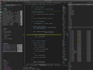

When I run this code, the enet initialization fails while trying to read the I2C EEPROM for MAC information.
EnetBoard_getMacAddrList calls EEPROM_read() 2 times.  I2C_EEPROM_MAC_CTRL_OFFSET is successfull, but I2C_EEPROM_MAC_DATA_OFFSET fails during SemaphoreP_pend in I2C_transfer().

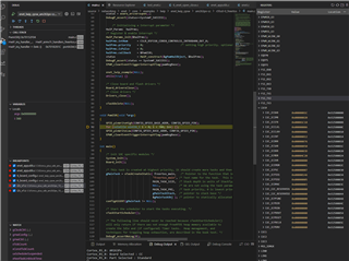

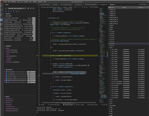

Here are some captures of registers from both calls to EEPROM_read():
  1. EEPROM_read(I2C_EEPROM_MAC_CTRL_OFFSET) before SemaphoreP_pend.
  2. EEPROM_read(I2C_EEPROM_MAC_CTRL_OFFSET) after SemaphoreP_pend.
  3. EEPROM_read(I2C_EEPROM_MAC_DATA_OFFSET) before  SemaphoreP_pend.   !!! never gets past SemaphoreP_pend

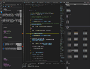

  4. Halted CPU to capture I2C registers.
I am surprised that I2C is not able to trigger the second time.  Curious if it has something to do with I2C ISRs overflowing.
Any help would be appreciated to determine the exact cause and how to fix this situation.    I am concerned it has to do with interrupt setup, that will become an intermittent issue later down the road.

  • Also from the 4th image, the Value of ICSTR register shows that there is an I2C overrun on the receiving end (0x1C18). If possible can you once try to reduce the frequency of PWM ISRs so they CPU has more free time to handle I2C interrupts. My suspicion here is that the CPU does not have enough time to service the interrupts and is hitting overrun. Just a speculation, might be incorrect.

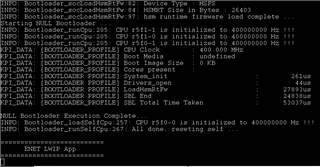

  • Hi Shaunak, please update the images, they look like broken links.
    I have resurrected the sample project and it looks like the release build works, but the debug still does not work.  Here are the updated instructions to recreate the failed project.
    Using CCS 20.1.1.8 and MCU SDK 10.2.0.15
    1. Import enet_lwip_cpsw example
    2. Right click on the following files and "exclude from build"
      1. main.c and example.syscfg
    3. Extract the following files into the project
      1. se_main.c and se_example.syscfg
      2. se_files.zip
    4. Change build configuration to Debug
    5. Build and run project
    6. Console should be stuck at "ENET LWIP APP" header
    7. GPIO65 / HSEC 86 / Breakout J21_18 should show waveform of when code enters PwmISR().  This should be 50%  (Release is smaller, hence the timing issue is not there)
    LMK if you still have issues reproducing the I2C overflow issue.  Thanks.

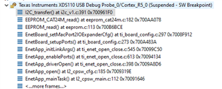

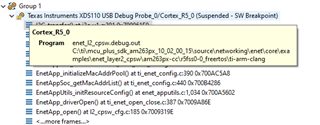

    I performed some profiling experiments, and sharing the results below.
    1. I was able to reproduce your issue yesterday, running into the same enet init failing. I hit the I2C_Transfer function once, but wasn't able to reach that breakpoint later. I tried profiling around PwmISR function in your main.c file which does GPIO Toggle. On average i see the breakpoint being hit every 50us for PwmISR (This aligns with the waveforms shared above by you).
    2. With the above observation, it is clear that all the other I2C transactions need to be completed within the 25us window we have. I also tried profiling the I2C_Transfer function. In total, during Ethernet initialization there were 33 times the I2C_transfer breakpoint was hit, some transactions taking longer, others not so long. For ethernet initialization to complete, all these I2C transactions have to complete successfully. These transactions are for MAC address fetching from EEPROM as well as configuring the MAC Port-2 IO Expander (function call stacks attached below) on the AM263Px-CC.
    Now, the time between 2 subsequent I2C Transfers was as follows (profiled from CCSTUDIO internal clocks)
    From the above profiling for I2C_Transfers, the issue highlighted. Before the I2C Transaction completes, a PWM High priority interrupt is received and the I2C transactions are left incomplete, hitting an overflow on the I2C side.
    All the profiling shared above was done over a debug build. The release build optimizes code for speed and size. You do see release build working (both Ethernet and PWM ISR). This aligns with our speculation of I2C transactions not getting enough time to complete, and High priority PWM ISR interrupting it, and causing the ethernet init to fail at a system level. In case of release build, code will be optimized and I assume the I2C transactions don't take a long time (as seen in case of debug builds). Due to this release build works OR if you make sure there is enough time free (current free time is 25us), the application works.
    Now from a PWM point of view, this does not mean the AM263Px cannot run at higher frequencies. As mentioned previously, in some reference designs and tests we have tested in the range of 500KHz-800KHz (making sure the ISR is small and deterministic). The issue is only when you have some long initialization process (like Ethernet in Debug builds). Such are the only instances where you would observe the combined (Ethernet + PWM) system failing.
