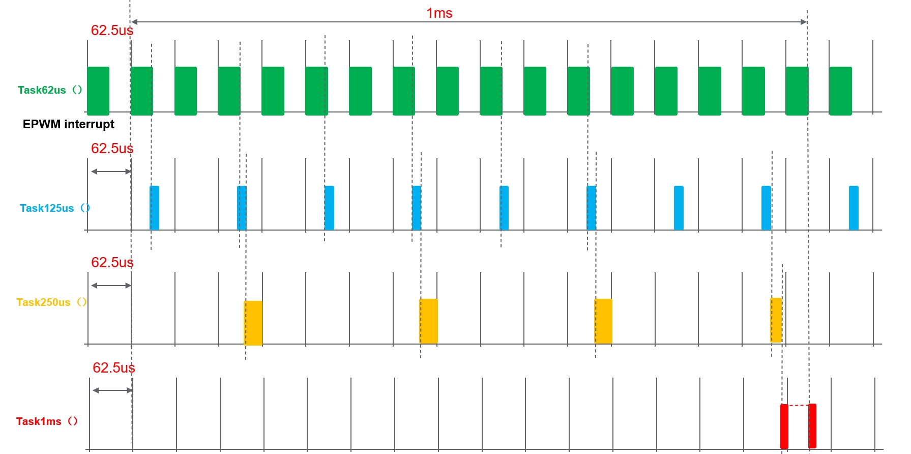

assume my work now have 4 types of tasks: 62.5us/125us/250us/1ms task.
run my 62.5us task need 30us,  but 125us 250us 1ms need time more than 32.5us, so i cant finish all my function within 62.5us, but 125us /250us /1ms don't need to execute every 62.5us
my solution
_interrupt 62.5us service()
    62.5cnt = (62.5cnt++ &0x0f)   //make sure 62.5cnt range in 0~15
    //always do 62.5us task
    //if (62.5cnt & 0x01)    do 125us task
    //if (62.5cnt & 0x03)    do  250us task
    //if (62.5cnt & 0x0f)     do 1ms   task
so in this way I can only use 1 interrupt ISR rather than 4 different priority ISRs can finish my work.
Above all, is 2634 support self interrupt nesting? how do I configure it?

    Task Schedule
    Configuration and code: (edit by demo epwm_valley_switching,delete gpio configuration)
