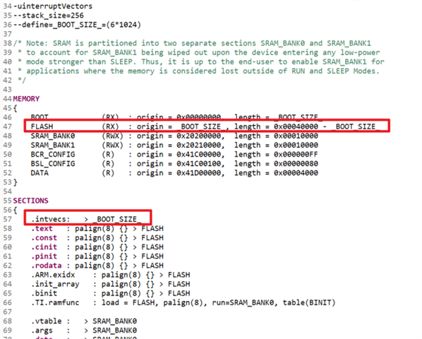

Hi team,
My customer is thinking to set a specific region for their application code.
Let's say they want to place their code starting from 0x0000001 to 0x00008000 flash region,
how should they change the code in sections of device_linker.cmd?
 Default: .text   : palign(8) {} > FLASH
Kenley
  • Hi Kenley,
    Sorry for late reply. Let me clarify for some cmd configuration rules about MSPM0:
    1. MSPM0 will always start from 0x0000 address after POR. So there should always be a boot program placed at 0x0000 address.
    2. Generally, we will try to make the application image start address aligned with 1 flash sector (1024Byte). So the start address 0x0000001 is not acceptable in this case.
    3. For example, if customer want to place the application code from 0x1800, the cmd could be such as: the FLASH region start address and the .intvecs address should be set as the desired start address. And another boot program should be placed at 0x0000 address to jump to application program.

    Is the following acceptable too ?
    'define _BOOTSIZE (0x0000_1800)
    MEMORY
     BOOT    (RX)  : origin = 0x00000000, length = _BOOTSIZE
        FLASH           (RX)  : origin =_BOOTSIZE, length = 0x00020000 - _BOOTSIZE
        SRAM            (RWX) : origin = 0x20200000, length = 0x00008000
        BCR_CONFIG      (R)   : origin = 0x41C00000, length = 0x00000080
        BSL_CONFIG      (R)   : origin = 0x41C00100, length = 0x00000080
    SECTIONS
        .intvecs:   > _BOOTSIZE
        .const  : palign(8) {} > FLASH
        .cinit  : palign(8) {} > FLASH
        .pinit  : palign(8) {} > FLASH
        .rodata : palign(8) {} > FLASH
        .ARM.exidx    : palign(8) {} > FLASH
        .init_array   : palign(8) {} > FLASH
        .binit        : palign(8) {} > FLASH
        .TI.ramfunc   : load = FLASH, palign(8), run=SRAM, table(BINIT)
        .vtable :   > SRAM
        .args   :   > SRAM
        .data   :   > SRAM
        .bss    :   > SRAM
        .sysmem :   > SRAM
        .stack  :   > SRAM (HIGH)
        .BCRConfig  : {} > BCR_CONFIG
        .BSLConfig  : {} > BSL_CONFIG
    Kenley
  • Hi Kenley,
    Sure, it looks good. You have correct flash size and sram size for MSPM0G3507 device.
    Pengfei

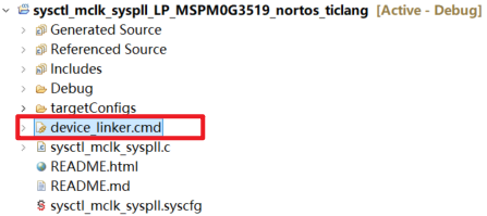

    Customer did as you guide by modifying the device_linker.cmd but when they build it , the modified part is going back to default one.
    Could you help us on how can customer modify the file without going back to default when they build the project ?
    Kenley

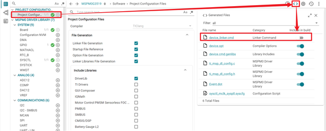

  • Hi Kenley,
    It is because the cmd file is default generated by SysConfig. You could follow below steps to modify the cmd file:
    1. Build the project, and the cmd file will be generated under Debug folder.
    2. Move the cmd file from the Debug folder to the current project folder, such as below:
    3. Open sysconfig file, and disable the cmd generation function such as below, and then customer could modify the cmd file and it will not be generated by sysconfig again.

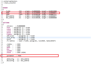

    For example customer would like to add .parameter in the section between .intvecs and .text.
    What should customer do ?
    For example:
    1. Edit the .cmd file as above such as:
    .parameter : palign(8) {} > FLASH
    2. Create a new source file .c in CCS project ?
    __attribute__((section(".parameter")))
    const uint_8t parameter[256] = {0x12, 0x34, .... };
    3. Add the following in the main.c file.
    extern const uint8_t parameter [256];
    Kenley
  • Hi Pengfei
    For your reference, seems like there is similar thread
    MSPM0G3507: Linker Command File - Arm-based microcontrollers forum - Arm-based microcontrollers - TI E2E support forums
    But it is not explaining how to modify the "SECTIONS" by adding userconfig memory in the "MEMORY".
    Kenley
  • Hi Kenley,
    Does customer want to store these .parameter section data into FLASH or SRAM?
    Generally the code will be stored in .text section in FLASH, and the variables in program will be stored in SRAM (.data, .bss, .stack).
    From your description, I think customer want to assign a section in SRAM to store some particular parameters.
    They could define the .parameter sector such as below:
    And as you said, they could then use __attribute__((section(".parameter"))) in their source code to define variables in .parameter sector.
    Pengfei

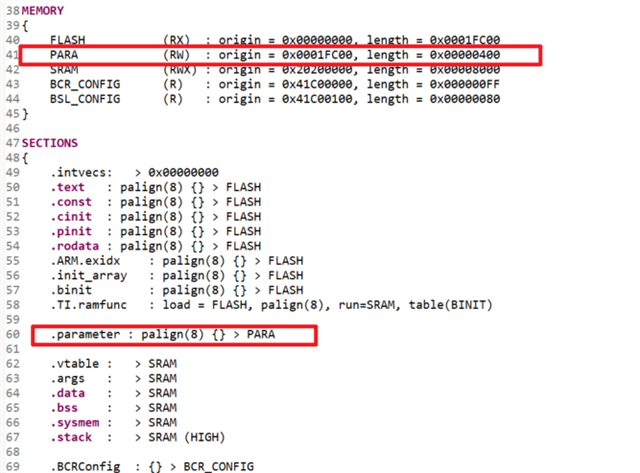

  • Hi Pengfei,
    Thank you for your support.

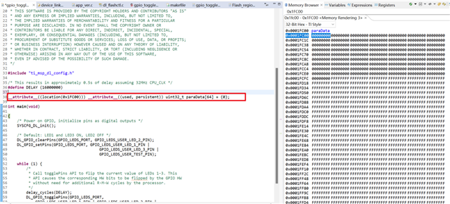

    They want to store these parameter section data into flash so the parameter data will always be there even the power is off.
    In this case, how should customer do it ?
    Kenley
  • Hi Kenley,
    Customer could follow below guide for store data to a point address.:
    1. Define the cmd linker file as below, this is mainly for reserve a flash region which will not be used for code.
    2. In source file, define the parameters at a pointed address location, and the initial value will be loaded when program downloaded.
    Pengfei
  • Hi Pengfei,
    A quick confirmation.
    So if customer want to change the value of the parameter, customer can change the value in the __attribute uint32_t paraData{64} = {0}; to uint32_t paraData{64} = {0,1,2,3,4,...};.
    Is my understanding correct ?
    Kenley
  • Hi Kenley,
    Yes, correct.
