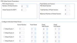

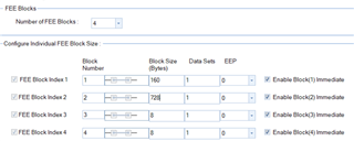

- 4 blocks of data (1 : 160 data bytes / 2 : 728 / 3: 8 / 4 : 8)
- Use 2 Virtual Sector : (2x8 Kbyte each)

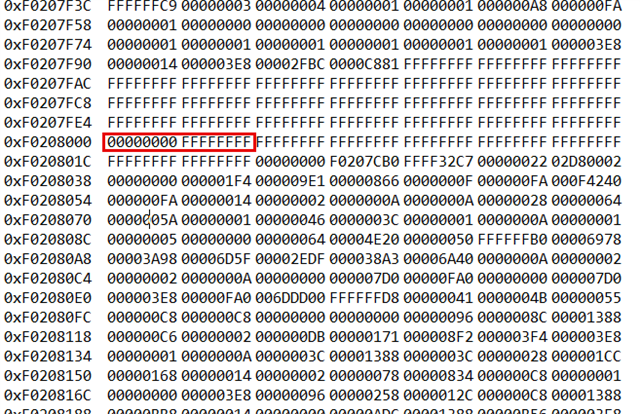

We manage to use them properly to save data, we can see the blocks incremented in the memory (new valid then old invalid), virtual sector changed until a point where end of Virtual sector 2 is reached (at 0xF208000), we cannot access the block anymore. Any Read or Write is failing.

    Sorry in my previous description, I made a mistake in the description "...point where end of Virtual sector 2 is reached (at 0xF208000)" --> I meant Virtual Sector 1. Indeed we are using the 64KB of or Flash in 2 virtual sectors (2*16Kb each). So the copy from Virtual sector 1 to 2 seems to not work.

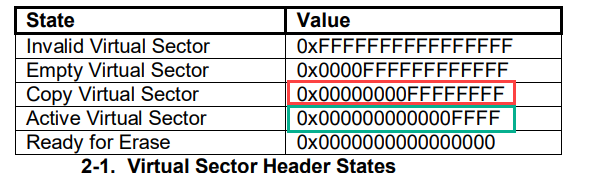

    When we have finished to fill the 1st virtual sector of 32Kb, we can see that virtual sector 2 takes the status "Copy Virutal Sector"
    But the Copy seems to not end ?.... and the Virutal sector 1 remains the active one and no more write or read operation are possible.

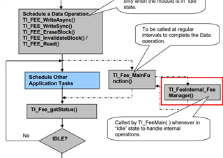

    So for the story it seems it was a mistake on my side for not calling the TI_Fee_MainFunction() function as periodic intervals to manage the Virtual sectors changes (copy, erase, invalid,...). I though somehow that using only synchro read write operation will also handle the virtual sectors changes but from the FEE manual, we need to call it. Especially the TI_FeeInternal_FeeManager which will copy and erase from one virtual sector to an other.
    Now, I see correctly that when fill up, my first virtual sectors has been erased :
    And my 2nd virtual sector from address 0xF0208000 is the active one with my valid blocks written inside.
