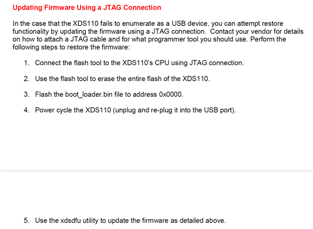

The XDS110 debug probe does not require a separate license for its use with the Code Composer Studio (CCS) IDE. The debugger DevPack, which is based on the XDS110 emulator, does unlock a free license to CCS.
I guess that the firmware of your xds110 was erased inadvertently. Please read the XDS110SupportReadMe.pdf in C:\ti\ccs1280\ccs\ccs_base\common\uscif\xds110 regarding updating the firmware.

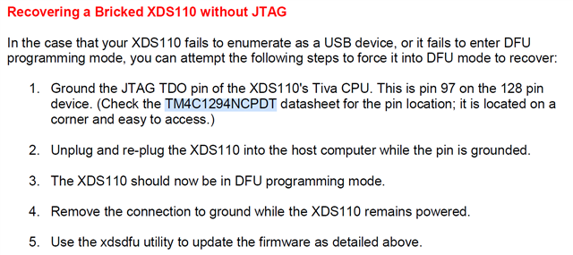

Because we do not have a JTAG connector on hand to connect the emulator and computer, we use "Recovering a Bricked XDS110 without JTAG" to burn bin files for the simulator.

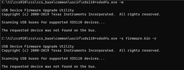

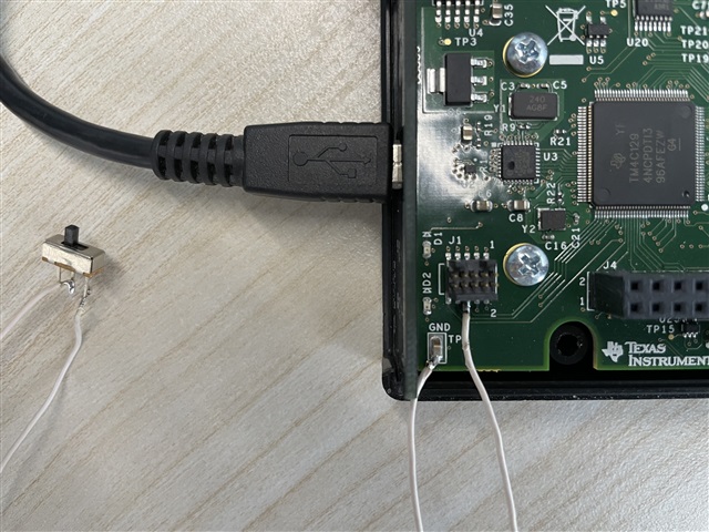

But when we run the burn command, the following error occurs. Can you help check if the above wiring meets the requirements? Thanks so much!

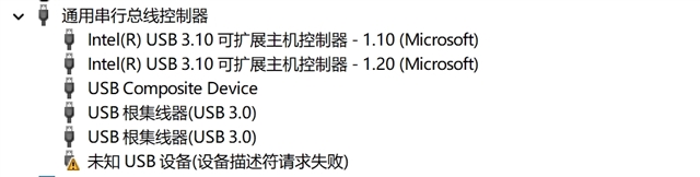

Because the firmware is erased, the CPU can not find the USB device.
Another way is to use USB DFU. TM4C129 is set to boot from USB DFU. You can transfer a binary file to TM4C129.
Can you please check if there is resistor on pin 59 (RBIAS) of TM4C129 device?
ETH#03 RBIAS Resistor Required Independent of the use of On-Chip Ethernet PHY

Thank you for checking. Can you replace it with a 4.7kohm resistor described in the workaround in Errata?

I don't what kind of connector (10-pin, 14-pin, or 20-pin) is populated on the PCB for TM4C129 device. I can use short wires (TDI, TDO, TMS, GND etc) to connect the working JTAG emulator and TM4C129 JTAG header.
