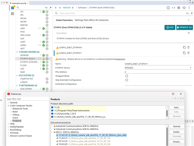

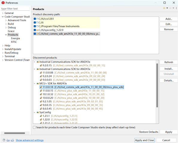

    Using the new ind_comms_sdk_am243x_11, I can complete the sysconfig following the blow two demo.
    ind_comms_sdk_am243x_11_00_00_08\examples\industrial_comms\ethercat_slave_beckhoff_ssc_demo\am243x-evm\r5fss1-0_freertos -- my project base on this demo.
   mcu_plus_sdk_am243x_09_02_01_05\examples\networking\lwip\enet_lwip_cpsw\am243x-evm\r5fss0-0_freertos

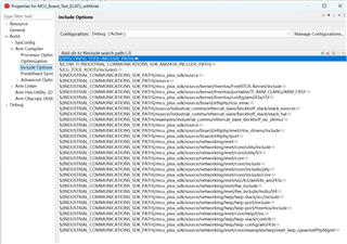

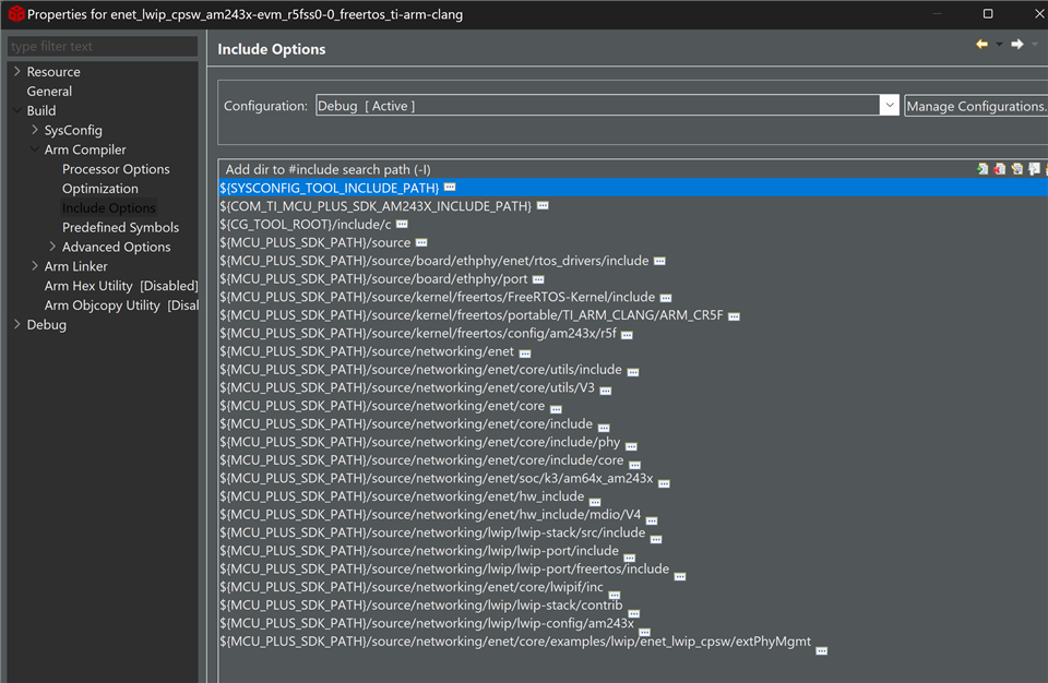

   There is no pin-conflict. And after I adding the include path, according to the CPSW demo, the Build is completed.
