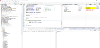

I trying to use the CCS10.1 serial terminal but not able to see any data even after transferring to SCITX buffer.
Help me with this.

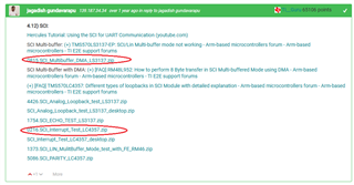

And also, i am suggesting you to refer the below tested examples once:

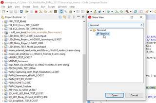

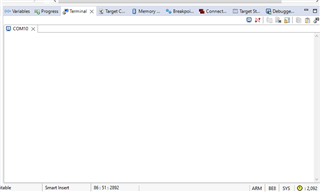

You can do it from CCS as well,

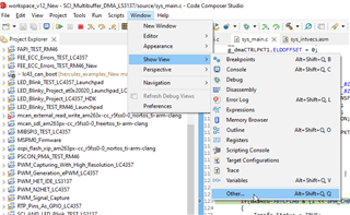

In CCS and in debug mode, we have a window called Terminal:
If you can't find this window after entering in debug, then use this search option:

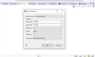

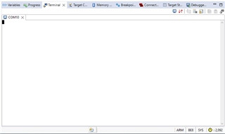

After opening terminal window here, you can configure the serial baudrate and other settings like COM port as per your board.
Once you configure then it will be ready to print your serial data in this window
Even you can give the input to the controller from this terminal by just typing from keyboard;

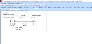

Remember here i changed the example baudrate to 115200:

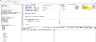

HI jagadish,
void sciSetupAndTransfer(void)
// Initialize the SCI module
sciInit();
// Define the data to be sent
uint8 data[] = "Hello, SCI!";
uint32 dataLength = sizeof(data) - 1; // Exclude the null terminator
// Wait until the SCI is ready to transmit
while (!sciIsTxReady(scilinREG))
// Wait for the transmit buffer to be ready
// Send the data
sciSend(scilinREG, dataLength, data);
I prepared this code from the same module this should print the data on the ccs terminal right?

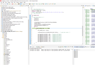

First i am suggesting you try this example code once:
SCI_AND_LED_Blink_TEST_LS3137 (2).zip
In this code i am toggling LED's for every one second and also in the same timeout i am printing the data on terminal "HERCULES" like as shown below.
This worked without any issues on my TMS570LS3137 board:
And make sure the terminal settings as below:
Thanks & regards,
Jagadish.

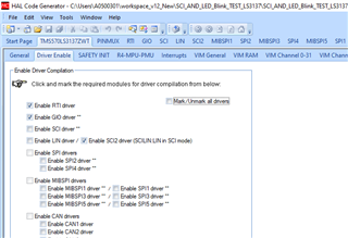

Hi Premsai,
Yes, it is important to use LINTX. Because the data will be transmitted on LINTX only.
As we are using SCI2 driver, which is combination of LIN and SCI, the data will be moved to the LINTX (B7) only.
