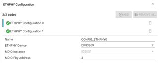

Hi Aaron,
Following your guidance in the above post, I did the test.
1 The link polarity is taken care when Enhanced Link is enabled. You can also disable Enhanced Link and see if you're able to scan for the device (which will point out whether the issue is with Enhanced Link configuration)
--I have test two kinds of Ethernet cable in case of the link polarity, I also disable Enhanced link in Sysconfig to test, and failed to scan my board.
2 tiesc_addOnBoardResetSequence() logic is implemented - which you already have taken care of.
--confirm this
3 tiesc_ethphyInit() logic has been modified to use DP83826 PHY and corresponding mods, instead of DP83869 PHY.
--do nothing here

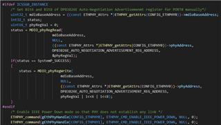

4 There is a strapping issue in our ICSSG0 add-on board for which a software workaround is implemented in tiesc_ethphyEnablePowerDown() API. You can remove this if this issue is not applicable in your case.
--I haven't met strapping issue by now, keep this tiesc_ethphyEnablePowerDown() here could cause something wrong?
