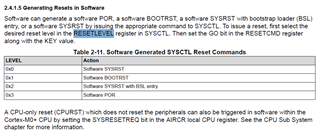

How to make  DL_ADC12_getMemResult(ADC12_0_INST, DL_ADC12_MEM_IDX_0) to zero after every read ?
How Trigger ADC using PWM ? (We want to take ADC reading at PWM/2)

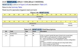

In MS430, Brownout reset by SW  PMMCTL0 |=PMMSWBOR. Any equivalent in MSPM0 ?
