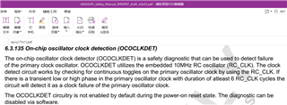

According to Safety Manual,how to Implement enable  OCOCLKDET ?
  • Hi Zheng,
    We need to verify the 4th bit (i.e.CLK_LOSS_STATUS_RC_CLOCK_LOSS) in the OP_RCM_CLK_LOSS_STATUS Register.
    This bit will give us the RC clock status that means status of on-chip oscillator. If this bit is logic-1 means the oscillator clock is lost, and if this bit is logic-0 that means on-chip oscillator is available.
    Thanks & regards,
    Jagadish.
    To add to the above response from Jagadish,
    Both bit-4 CLK_LOSS_STATUS_RC_CLOCK_LOSS
    and bit-0 CLK_LOSS_STATUS_CRYSTAL_CLOCK_LOSS
    can be checked to detect clock loss of RC-clock and Crystal clock respectively.
    For related details, please refer to section "6.4.4 Limp Mode" in the TRM.
