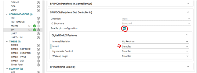

We are trying to invert our SPI signal, however the Invert option is not available in the Digital IOMUX. What could cause this issue?

I just tried this with one of the Examples (spi_controller_multibyte_fifo_poll) and changing Invert (as in your screenshot) to "Enabled" resulted in a call from ti_msp_dl_config.c to DL_GPIO_initPeripheralOutputFunctionFeatures(GPIO_SPI_0_IOMUX_PICO) with DL_GPIO_INVERSION_ENABLE.
Is that what you see?

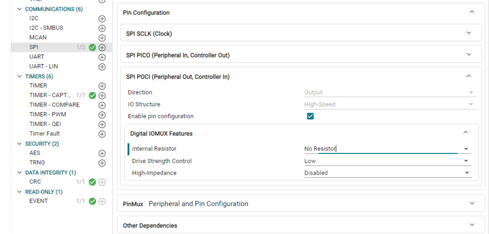

Hi all,
Sorry I used the wrong screenshot, the setting is not appearing in our sysconfig. What could cause the setting to be removed?

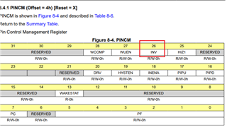

Also, you can init the invert function in your software code, to set this bit manually:

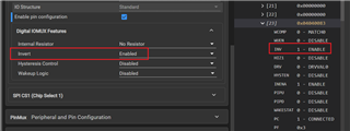

Based on CCS20.2 and SDK 2.05, I can successfully change Invert in a SPI signal.
spi_controller_multibyte_fifo_poll_LP_MSPM0G3507_nortos_ticlang.zip
